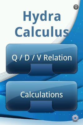

Popis: Simple and practical set of utilities for the calculation of water pipes.
- Now, you can setup the fonts sizes.

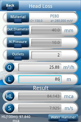

Load Loss Calculation.
Based on Hazen-Williams formula incorporates the coefficients of different materials. Incorporates multiple outputs (same value) coeficient ( F Christiansen).

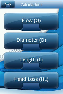

Inverse calculation.
Knowing the pressure drop (or Pressure available / slope), you can calculate the other parameters such as flow, diameter, length.

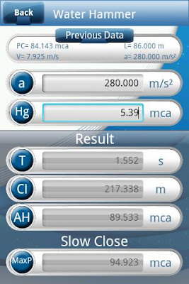

Calculation of water hammer.
Based on the calculation of downtime Mendiluce and Allievi formulas (fast closing) and Michaud (slow closing).
