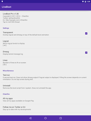

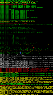

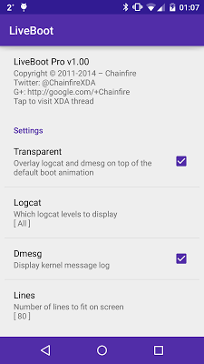

Popis: LiveBoot is a boot animation that shows you logcat and dmesg outputs on-screen as they happen.

http://ul.to/5or688iyA feature is built-in to test your current configuration without rebooting. The lines shown in test mode may be limited and relatively static, this does not reflect exact boot time behavior as much as it just shows you that it works and how big the text will be.
Note that LiveBoot will only show up after the data partition is mounted. If you need to enter a decryption key or pattern at boot, it will not show up until you have done so.

There's an in-app purchase to upgrade to Pro, which supports my developments, and unlocks the transparency option as well as logcat buffer and format selection.
